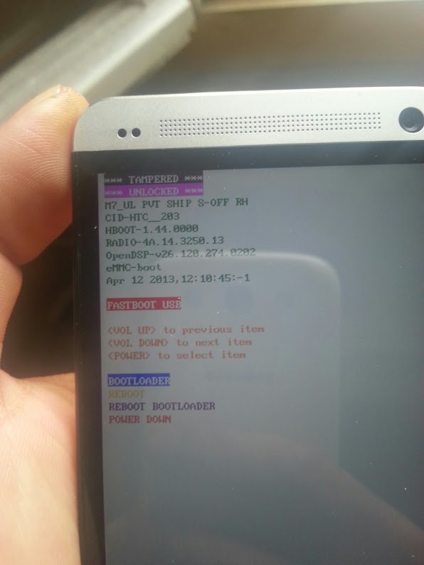

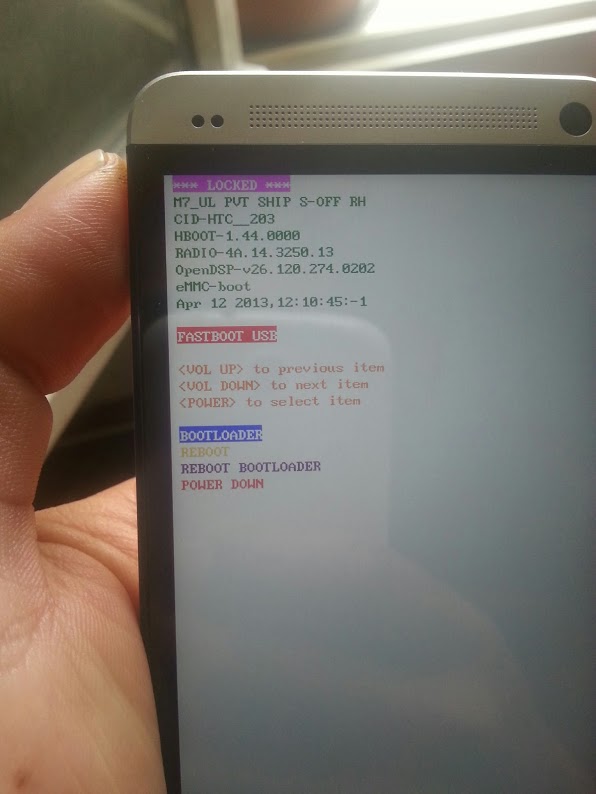

13. Rebbot phone in from the bootloader
14. Started the adb shell, again: adb shell
15. Changed to the folder where revone is stored: cd /data/local/tmp
16. Requested revone to reset tampered flag (again): ./revone -t
17. Exited the adb shell by writting: exit
18. Rebooted to the bootloader by writting: adb reboot bootloader
19. S-OFF and tampered reset...yeah baby...
http://forum.xda-dev...4&postcount=151
